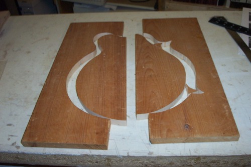

Hi folks, i've been a slacker lately, especially regarding progress pics so here they are, i've been making some jigs and templates for the mandolins that i'll be building, i thought i'd share at least what i did so far on this, i'm new to mando building as well.
I bought Siminoff's book and also the Macrostie's plan from LMI for Loar's F5, it's such a different game somehow, everything is so small but i feel i can do it!

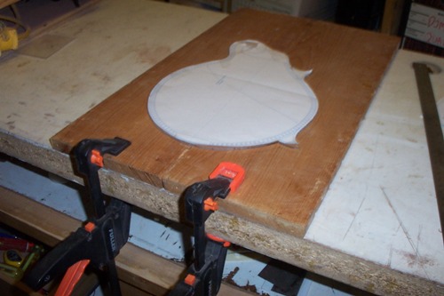

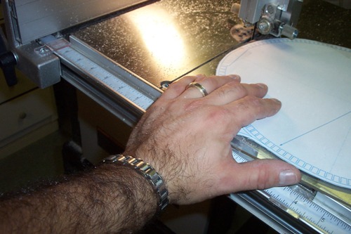

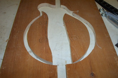

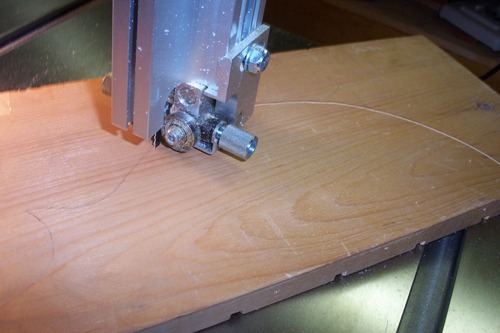

Making a plastic template for the body mold, cutting it on the bandsaw

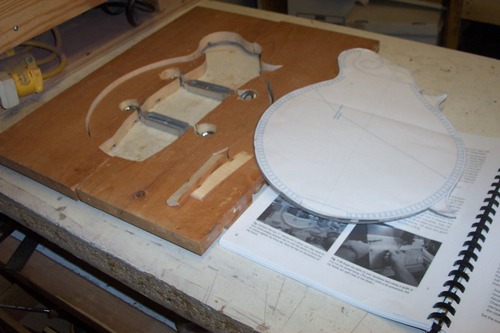

Making of the body mold
Preparing for the spreaders

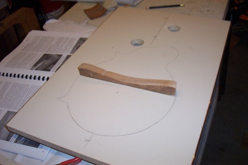

This jig is for when you glue the neck to the body, the holes in the board are there to allow the clamps to reach from under the board

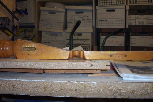

This one is a piece of recycled furniture turned into a neck support for carving the neck, it will be held in a vise and the neck will be clamped to it.

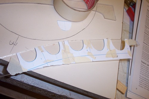

This will be a multiple -neck contours template, i put them sisde by side on plastic and will cut the contours with the bandsaw, i like the idea of having them all on the same piece, easier for storage or to avoid the loss of such small pieces.

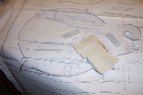

As we have communicated about earlier, I would ditch the Siminoff template and use your McRostie plan as a reference instead, meaning you will have to shim / sand your your current mold here and there.
One more thing I notice: Your template is missing the "button", the part where the back extends over the neck heel. Make sure you remember to leave enough wood for that part as it is an important structural detail. Some of us have forgotten to do so because our templates at the time were missing this detail .

Thank you very much again Arnt, just what i needed, i went back to the shop for a quick glance at Macrostie's plan and now know what you were talking about for the "button", ok, no more excuses on my part then, i'll scrap that body mold and make another one that will be sturdier with Macrostie's plan. I just saved your post, i will rebuild the body mold during the coming week end and thanks for the templates and copy tips!
I'll be also doing the straight mortise joint, i'm more comfortable with them than the dovetails.
As said above, will redo the back template including the button as an important structural detail that i sure had missed, i'm sure glad i PMed you for advice brother! Will keep you posted on all the changes to come.

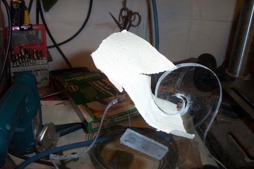

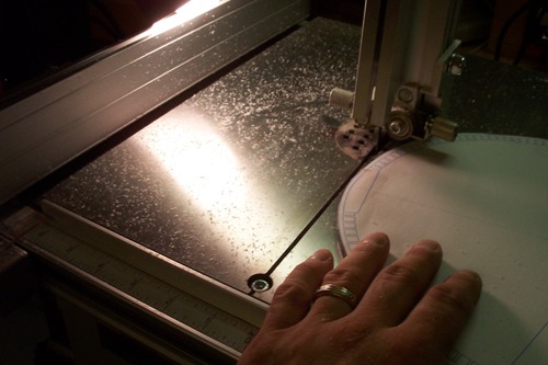

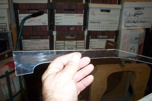

Well, i listened to Arnt's great advice and redone the body template and added the button that was missing, i made it wit some plexiglass i scrounged from an old aquarium lid Thanks Arnt

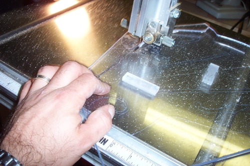

here we go again on the bandsaw!
A bit of sanding around the edges
I must be getting old, i used these for the first time, it was really helpful when working around the scroll area

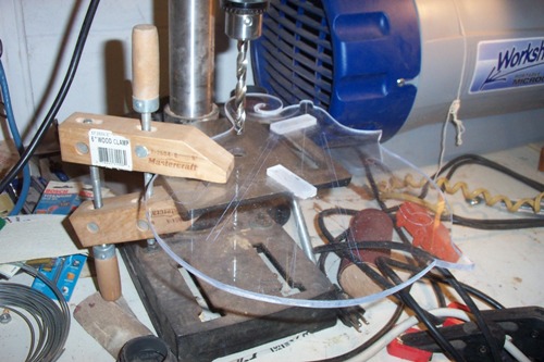

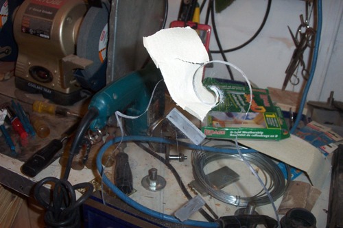

using the drill press to pierce the f-hole to be able to locate them properly on a future top

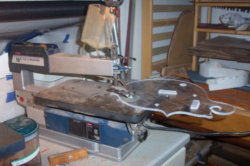

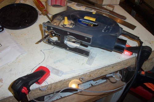

Tried to make my way inside the F hole with the scrollsaw but it heated the plexiglass to much making it melt and close back,
Had to use the jigsaw to finish it!
AAH, the learning curve!
